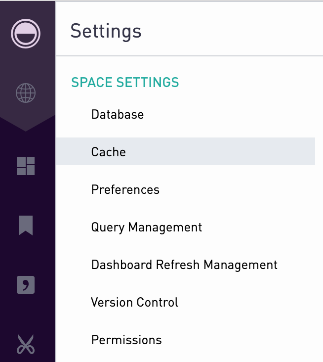

2. Prepare an Uncached Space
“Data Engine on Your Warehouse” will only work on sites/spaces that do not have a cached database. A quick way to check whether a space is cached is to see if the “Cache” tab is available underneath in the “Settings” gear icon:
If the site is not cached, then proceed to Step #3.
If the site has the Periscope cache, then a new space must be created. This new space will be used for all subsequent steps. By default, the new space will cache upon connecting a database. After completing Step #2, please contact Periscope Support to un-cache that space. In the interim, you may proceed with the following steps.

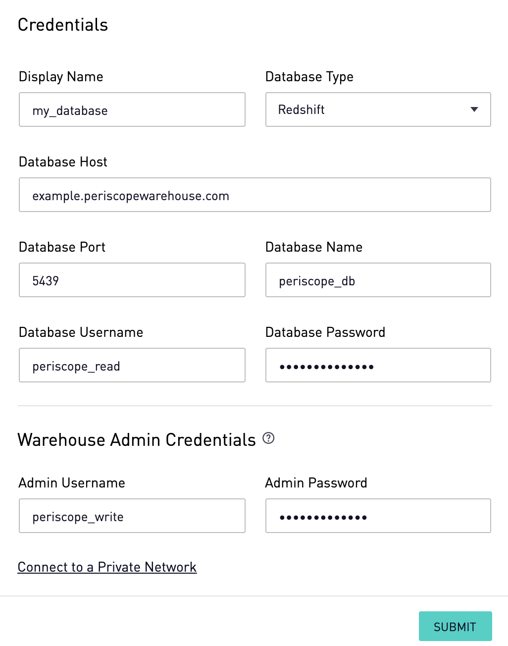

5. Apply the Write User
Click on the “Settings” gear icon in the lower-left corner of Periscope, and navigate to the same “Database” page you used to connect the database in Step #3. If there is a drop-down available, ensure that the database from Step #3 has been selected.
At the bottom of the form, there should be a section to input the “Warehouse Admin Credentials”. This will be the username and password configured in Step #5. Fill in the text boxes with the correct credentials and hit the “Submit” button.
